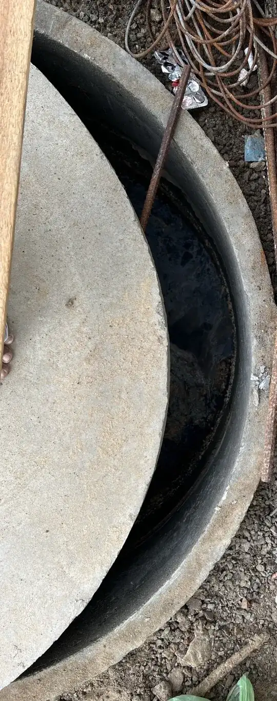

My house has 6 dry wells for collecting waste water from bathroom and kitchen.
I'm worried that it could become a breeding ground for Mosquitoes , Bacteria, virus and foul smell.
Are there any guidelines on how to treat the water so I can prevent harmful effects ( Malaria,Dengue,Legionella etc..)

Amogam
  • 145
Firstly let me assume you that the dry wells do not contain septic water that is from toilet flushing. Drywells are for "Gray water" from sinks or tubs, and rain water that collects. Carbon monoxide is a byproduct of combustion, and would not be an issue. Methane is produced from decaying sewage, and is not odorless. The smell resembles someone passing gas. Your dry will should not be producing this smell. You can shock the drywells with a cup of bleach in each one, If there is standing water, That should take care of any micro organisms in it. Please contact a professional to inspect your septic system to make certain that it is not leaking into your groundwater, And collecting in the dry Wells.
Alisha Pratt
  • 218
If you believe the smell is entering the home from the pipes and not through an open window / opening in the structure, then you may want to check two things:
  1. There are p-traps on all lines running to the dry well from the house as these are a simple method to block gases from coming back in
  2. If there are p-traps on all, then ensure you run water often enough in each of them to not let the p-trap dry out which would compromise it's effectiveness
