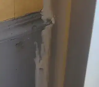

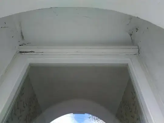

The top of the frame was left looking like this. Shouldn't they have replaced the whole frame? Poor quality top of door frame

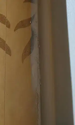

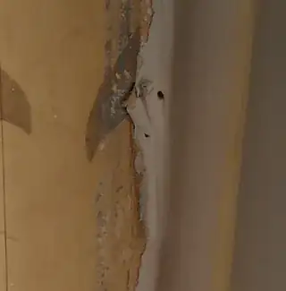

The new sealant around the inside seems to have been applied by a novice in an extreme hurry: Poor quality sealant Poor quality sealant Poor quality sealant

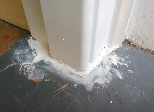

The bottom of the frame looks a mess: Messy door frame

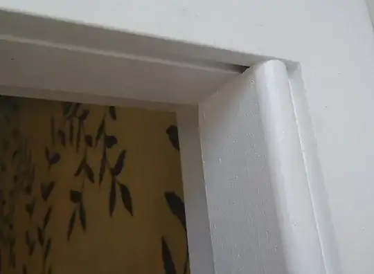

There are no mitred corners in the frame: No mitred corners

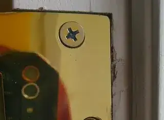

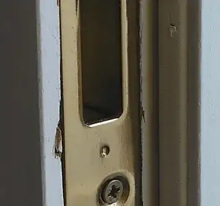

Where the ironmongary is sunk into the frame, it's not very tidy:
Poor quality door fittings Poor quality door fittings

It really does look like a hack job. The piece on top of the frame is sort of crown molding and replacement should have been specified in the contract. The contractor should have at least caulked the seams to make it look better.
The caulking is horrible and should have been smoothed out and cleaned up especially at the bottom.
The mitered frames are also something that should have been mentioned in the contract but many windows I've seen don't have them.
The hardware cutout looks sloppy too. There are some nicks and gouges that should have been repaired. The corner and spacing is also bad for a professional job.
