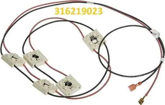

On our Frigidaire range of roughly the same age there was a weak spark issue on some of our burners as well. Issue wasn't with the igniters or anything with the burners themselves. Instead the electrical contacts behind the gas valves had just become gummed up with carbon deposits. A new harness was stupid $ but not too difficult to just disassemble the switches and clean the copper contacts. No parts required.
Igniter Harness
The igniter circuit is always HOT so be sure to unplug it first!
