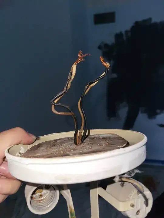

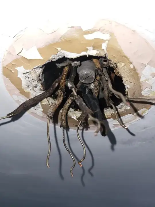

enter image description hereI am trying to install a new light fixture, but there are 9 wires--I wasn't able to see how it was connected and I'm pretty sure it was wrong to begin with because bulbs kept burning out right away. Initially the whites were together, 3 of the black wires were together (including the hot wire), and one single black wire. There are 3 pairs, and one bunch with 2 blacks and one white. The casing is literally crumbling at the touch.
How can I properly wire this to a new fixture?

From the looks of those pictures you won't be able to properly wire this without some major rewiring. Those wires have insulation that is cracking/ crumbling all the way up up the connectors that hold them in the box. You would need to identify all the wires and would need to turn on the power to do that. That box is a fire waiting to happen and you do not want to be up on a ladder when it starts arcing. Those wires need to be replaced, up into the ceiling and maybe even further. If you have an attic and can get to that box, the job might be easier. If no attic, you're looking at making holes in the ceiling. I love DIYers but this is one of the very few times I'm going to say you need some professional help.

Professional Electrician here, I hate to say it, but those are fabric coated wires, they stopped being installed in new homes back in the 60's and very early 70's. Any surviving cloth wiring is way past its service life now. I know its going to be expensive, but if you dont want to risk burning down your house, this wire needs to be entirely replaced ASAP. Yes a total home rewire is going to be between a 2 and 10 thousand dollar job, but it needs to be done. and this is no DIY task, you need to call in the professional's for this one.

Disconnecting all the wires from each other was a major blunder.
At first glance, I thought "Oh no. You pulled them all apart. Now we'll never know how they went."
This is actually quite terrible. Because now we're playing "Chinese Whispers" via your recall of how the last guy did it, and that work is not 100% reliable. Normally this is the point where I say "essential data has been lost, time to call a pro with tracing tools and experience".
In the future, simply cut the black and white small leads off the old fixture, and don't mess with the bundles of cable from the walls. Then splice the new leads to the old leads with a blue or gray wire nut.
But if you're sure about what you say about the configuration, that is plausible assuming the "solo" black wire is in the /3 cable. (that would be a modern post-2011 switch loop, actually.) I hope you know which one that is, though experimenting with that particular issue is probably not unsafe.
The deterioration might have been from bulb heat.
The disintegrating insulation on the wires may be from the heat of incandescent light bulbs previously used in the fixture. In particular, many people enjoy ignoring the "60 watt maximum" stickers inside fixtures, and that will cook the wire insulation and even start a fire.
If so, the insulation will be more sound as you get farther away from the fixture - the worst damage will be on the wires going to the fixture. If you find the insulation toward the end of the wire is solid, it'd be possible to save the day with some shrink-tube. You want the better shrink-tube that shrinks 3:1 so it can slip over the old insulation and still wrap the wire decently. A double layer (one over the bare wire and one over the insulation and first layer) would be better still.
Regardless, I would not continue this wire in service without installing an AFCI breaker at the panel, or AFCI receptacle or deadfront at the first opportunity past the panel. Wire arcing is at high risk for starting a fire, and an AFCI gives you the best chance to detect that.

Regarding the wire quality and whether you should replace these wires, I personally can't tell from the picture. My experience with this style wire construction is that it always looks like that. But, you say it's crumbling off just from touching it. If that's exposing the copper, then some wire replacement is vital. Regarding the fixture, it looks pretty old and crusty. One of the wires looks stripped near the fixture. I'd get a new one. Or maybe that's the old one?

You have to find out with certainty what each of those wires are. One may be the supply of power, one may go on to other outlets, one or more may feed switched power to other lights in the same room, one or two may be switch loops for a light and fan. Some of them may be disconnected at the other end, some may even terminate in walls. Hopefully in junction boxes with wire nuts but in many cases you'll find disused wires terminated poorly with just tape. With that many wires, hopefully you can figure out where each one goes but if not, you have good reason here to worry about poorly terminated wires inside the walls.
Some of those are badly damaged, as noted in another answer. Sometimes they can be repaired but you have so many wires in such a small box it will be impossible to repair the brittle old ones properly.
I'm afraid I agree with other answers here: you should crack open at least a bit of the ceiling, and probably more than a bit, to replace damaged wires, discover and remove disused ones and understand what they all do.
