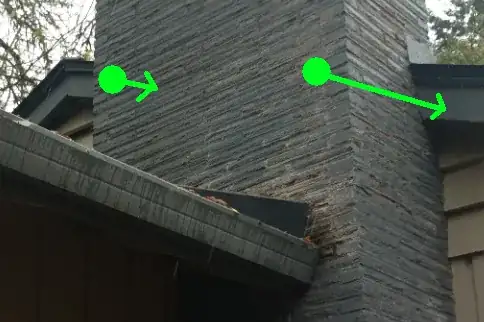

The Chimney:
Approximate drill points are drawn in green:
chimney anchors

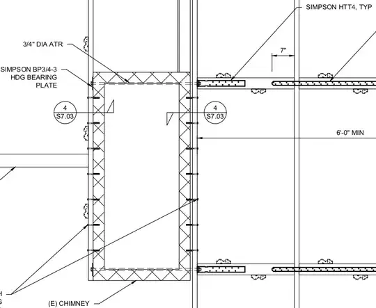

Engineering Drawing:
You can see the 3/4 ATR drawn in dashed lines at the top and bottom of the chimney. Note that detail 4/S7.03 is not relevant to this SE question:
chimney, top view

You need to drill this from the inside, because that’s the critical location for the tie-back to be connected. Level and inline with the joist will be close enough by virtue of following the bottom of the joist. If it becomes really easy to drill after a few inches, it means you’re in the flue — just keep sideways pressure on to not wander too far into the emptiness.
Use a rotary hammer drill and a drill bit that’ll do it in one shot. 36” bits can be found for surprisingly low prices these days. Don’t push too hard on the last inch or you risk a big blowout on the exterior brick. 7/8 would work, though you can probably get away with 3/4.
Any silicone sealant will work to seal the holes. Use plenty.
Be sure to be safe at heights: either a fall arrest system or scaffold or both would be prudent.
