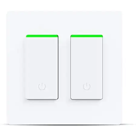

To clarify: are you talking about an actuator in each switch, that mechanically flips the other one into the same position? This particular product I'm not aware of (although it may exist, I haven't found any).
I would suggest going the IoT route instead, and mate several RC switches to the same light (you additionally insert a small control unit into the wall/ceiling socket to make this work).
There are product lines that provide an indicator light as feedback that would be visible on both switches once the light is on (a system with two way communication is required though). Random example (there are many):

Don't invent something. It's already obsolete.
This problem has been eclipsed by smart switches, as MiG covers fully.
Naturally, just like in modern cars, the trend is to eradicate actual physical controls, and make them virtual.
