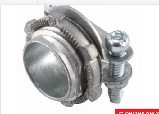

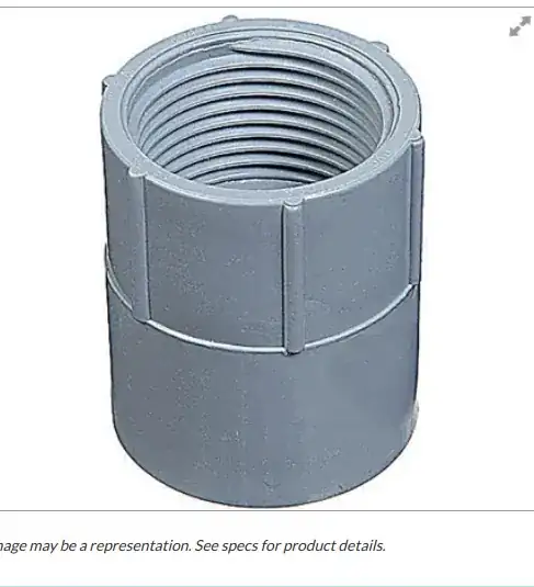

You can get a female adapter like this enter image description here
and attach it to your PVC and then screw this adapter into it after removing the lock nut (Stock photos from home Depot). You can also add a PVC 90 degree sweep in the direction of the run if neatness counts.
