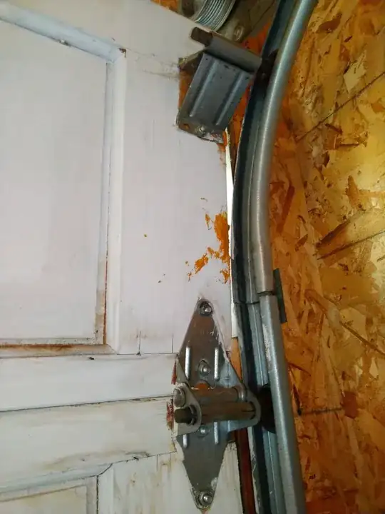

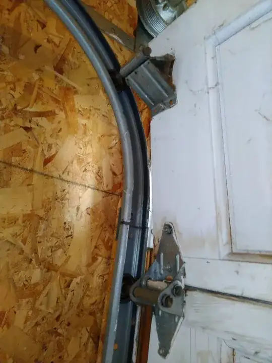

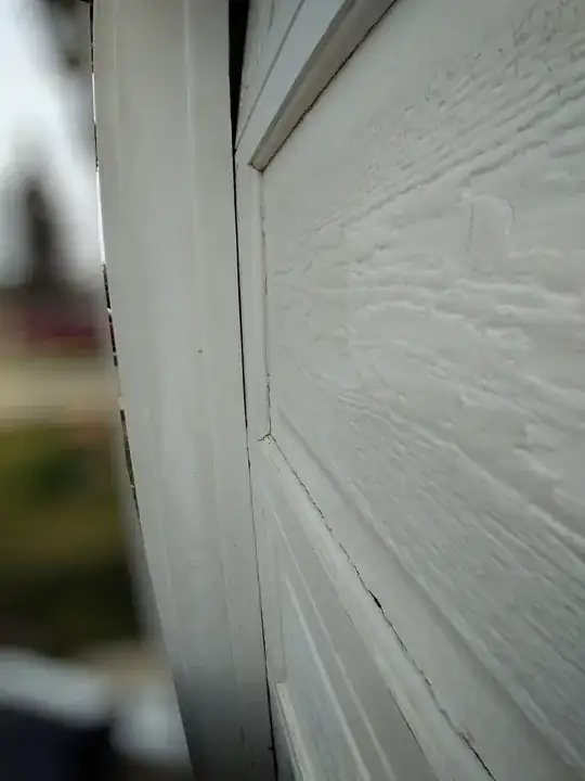

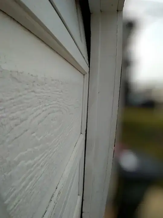

My garage door currently rubs on the outer wooden frame, and this prevents it from closing fully. As it closes, the motor seems to sense the resistance and it starts pulling the door up instead.
The rubbing seems to be greater on one side (the right side when looking from the inside out).
It's a wooden garage door, likely from the late 80's.
Here are some photos from the outside and inside:
Side 1 from outside Side 2 from outside Side 1 from inside Side 2 from inside

For me the easiest solution would be to remove the 7 foot long framing laths (Profiles) on both sides.
They are just nailed in, so easy to remove.
Now sand off some in the area that you marked.
Nail them back in, using a spacer.

Mark the door frame where it touches/rubs against the door.
With the door open sand or use a wood plane to remove the rubbing sections.
Close the the door and check. Repeat as needed. Probably only need less than a 1/16 inch removed.
When you have removed enough, paint the bare wood for weather protection.
Can also take down the door frame and move it away a bit from the door when putting it back up.
