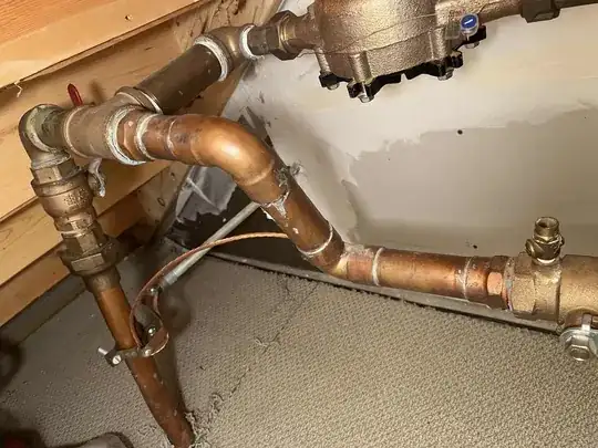

Image 1. The Main water line enters the house.  There is a valve with the red handle.  Then It splits into two lines.

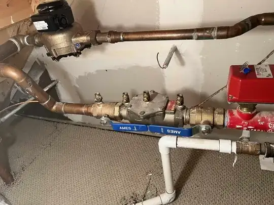

Image 2. The Water meter is in the top one. The Bottom one has two Blue valves. I suppose backflow prevention system is right here. Then it has the Potter switch.

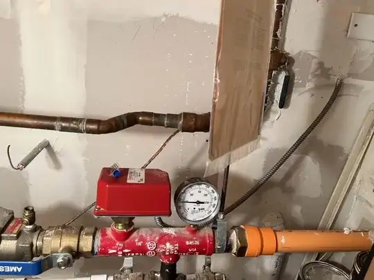

Image 3 Top line has valve with green handle down the line from the Water meter.  Bottom one got Potter switch and pressure gauge along with white plastic tube going down from the potter switch.

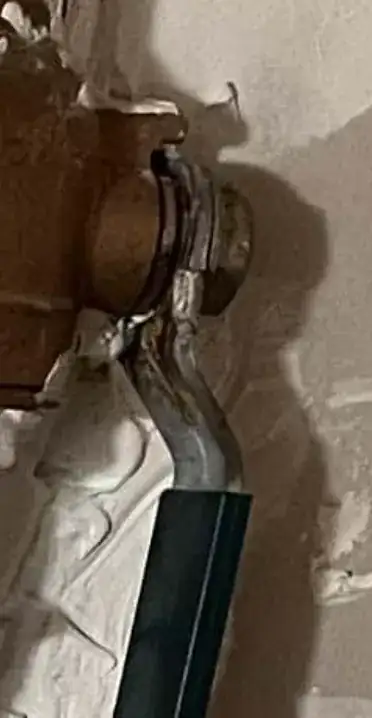

  1. Which one is the main shutoff valve here?  Red one in the first image. This is before the meter.  There are two Blue valves in the second image.  I could easily turn them off. Green one in the third image.  It makes sense this would be the main valve.  This is down the line from the meter. However this is positioned in a way I cant turn it.   It is right next to the wall.  Can I shut off both blue valves to cut the water supply? Will it affect the backflow prevention system?
 2 It appears both the top and bottom line go into the unit. Bottom one comes out before the water meter. How do the City calculate the usage for the bottom line then?
3 Why the Backflow prevention and Potter switch are in the different bottom line, not in the same line top where the water meter is? How does it work?
  1. What is the purpose of that white plastic tube which comes out from the Potter switch?  Since I am an amateur, obviously I have no clue about this.  Thank you for your time.

I'm pretty sure I can't pull away the green valve.  I have no clue why it was installed in such a way.

The two blue valves are part of your fire sprinkler's backflow preventer
From the arrangement of parts there, we can see that you have a classical fire sprinkler riser/drain installed, with a waterflow switch (Potter is one of the major manufacturers of such parts) that sets off some sort of local alarm (such as your smoke alarms, or even a local bell/horn) and/or interfaces to an alarm panel that can call whoever's monitoring your alarms if the sprinklers ever start flowing water, presumably because a fire caused one of the heads to open.
The white pipe is a drain pipe from the test drain on the system; opening the valve connected to it (located below the waterflow switch) will set the waterflow switch off, and should be done as part of the normal annual checks of the system. Of course, if you have an alarm panel and monitoring company, they'll need to be informed of what you're doing beforehand so they don't dispatch the fire department to a nothingburger!
Going back to the blue valves, though, those are the shutoff valves for the backflow preventer your water utility/local jurisdiction requires to keep sprinkler water (which can get very stagnant, unlike your normal house water, which is used on a regular basis and thus doesn't need any protection beyond the normal measures of air gaps at fixtures and vacuum breakers on hose bibbs and irrigation systems) from backing up into the domestic water system in case of a water main break or water pressure shortage. These need to stay open at all times, as the sprinklers won't have any water to do their job when they're closed. In fact, they shouldn't be left unsupervised as they are now; instead, they either need to be chained and locked open with a good quality lock, or have tamper switches hooked up to them so that they can generate a supervisory indication to your alarm panel when shut, provided you have an alarm panel that's capable of that.
The reason why they're there, and the primary reason why they need to be shut, is because the backflow preventer itself must be tested on a regular basis, and the test procedure requires the use of those valves for short periods of time. (This is what you've been witnessing the plumber doing -- the gadgets they use for this purpose are merely a set of pressure gauges that let them "see" what is going on within the backflow preventer, since it runs entirely on water pressures.) They can also be used to shut down the sprinkler system so that a fire protection contractor can drain it to do work on it, or in case a sprinkler head gets whacked or activated by a fire that's since been extinguished and overhauled, and thus needs to be replaced with a fresh head.
The red valve is a master shutoff, and should also be locked open or supervised
Going upstream, past the water meter on the domestic side, we then come to the red valve. This is in the incoming water main before it splits into domestic and fire branches, and thus shuts off both your domestic plumbing and your fire sprinklers when closed. As a result, unlike the blue valves, you'd at least stand a chance of noticing if someone shut it off out from under you, but there's still a cogent argument to be made for locking it open or electrically supervising it in the same fashion as the blue valves.
Furthermore, since the meter is in the branch feeding your household plumbing, your fire sprinkler supply is unmetered. Given that it'll only ever flow a non-trivial quantity of water in case of a leak (damaged sprinkler head) or a live working fire in your house, most water purveyors don't care to meter fire sprinklers, instead treating it like the fire department using water from a hydrant to fight a fire, and at most charging a fixed fee to you for having a sprinkler system.

Main shutoff (everything) is the red handle in the first picture. Green handle is "everything that's not the fire sprinklers" and should pull away from the wall so it can be operated if it wasn't installed by an idiot. If it was installed by an idiot you might be able to remove a nut and change the handle position 180 degrees (and replace the nut) so that it can be operated. However, looking at the picture closely, it appears to be installed correctly.

Close up from OP's picture
The arrangement of the stop lug on the bronze valve body (upper middle) and the stop lug on the galvanized steel handle (below that, still middle) show that you can pull the green handle 90 degrees out from the wall to stop the flow. If you have a hard time grabbing it, slip something behind the handle to pull on, or slip a hollow tube over the handle to extend it.
Blue handles are to allow replacement/service of the item between them (backflow preventer, you think - or perhaps a special fire sprinkler thing to allow the sprinkler lines to be pressurized with air until a fire - which permits operation in an unoccupied, freezing house, so long as the basement water entrance hasn't frozen.)
White tube appears to be a drain, but without seeing the other end, unclear. Drain is one of the two things it says on the casting the "Potter switch" is screwed into where that connects. Probably to drain the sprinkler section.
