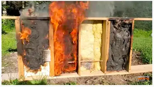

Here's an example of how different grades of insulation materials react to fire. The stuff in the #2 bay is polyiso, and the #1 bay is several grades of spray foam - all architecturally rated product by the way.
https://www.youtube.com/watch?v=CdItsso3ur0
Don't miss the surprise at 13:20.
