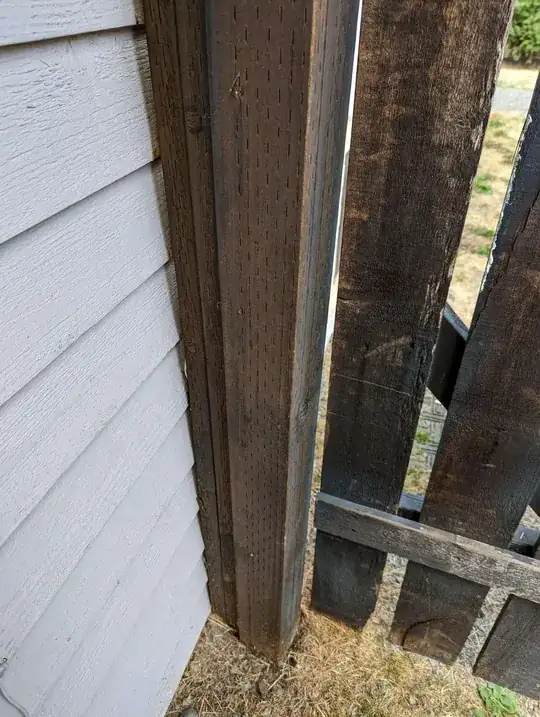

I want to set a fence post that a door will be latching into. This post is currently attached to the siding through a couple of 2x4, and it just became detached of the siding. So, I am trying to find for a better solution.
As you can see I don't have a lot of space between the house and the door, so I am not sure what is the best way to do this. Should I dig a hole and bury the post with concrete in it? Should I put concrete and a U-bracket and have the post above the ground?
Updates:
  • I live in Seattle, WA. Not a lot of extreme temperatures (a couple of snow days in winter, and a couple of heat waves in summer), but constant rain.
  • I attached the picture of how the post (on left) is currently set up. Attached to the siding with screws via a couple of 2x4, but really wobbly (hence why I am trying to change this).

Pour a new small piece of concrete connected to the old add a U post bracket to the concrete and bolt the post to the bracket.
You can drill a hole in the footing and epoxy a piece of rebar to tie your new concrete to your footing (if that is what you hit). I wouldn't remove a piece of the footing.
There are other options but without a picture it is hard to give recommendations.
