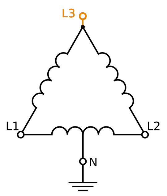

The term High-leg refers to a specific type of 3-phase electrical service (called a high-leg or "wild-leg" delta) in which one of the phases is tapped at the center to provide a split-phase supply like what you'd traditionally get in a US dwelling.
For example, a 240V 3-phase "high-leg" delta gives you:
  • 240V phase to phase (L1-L2, L2-L3, L3-L1)
  • 120V phase to neutral on 2 legs (L1-N and L2-N)
  • 208V phase to neutral on 1 leg (L3-N: the high leg)
The busbar connected to L3 in this instance is the one that needs to be specially marked so that 120V equipment is not connected to any single-pole circuits on that bus, which will have 208V in this example.

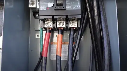

This is what they are talking about when marking with orange:
The second leg in that example is your high leg.
