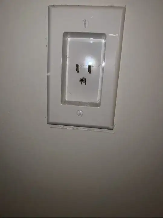

Have a male plug installed into drywall about a foot above the baseboard level. Above that, at tv installation level, is a normal female outlet with a tv cable line. What would the male plug be used for?enter image description here

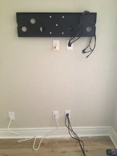

You may notice that the normal socket behind the TV is dead.
That's because it is fed from this inlet.
I assume you also have a normal receptacle near the floor somewhere. Plug a surge suppressing power strip into that. Then, take an ordinary extension cord and plug the pointy end into the power strip and the other end into the inlet. Now, the socket behind the TV has power.
And it is surge protected. And it switches with the power strip!
Also, they make power strips that sense the TV being turned on, and only then will power up the other ports on the power strip. That prevents your cable box, XBox, Roku etc. from sitting there wasting power the rest of the time. This setup makes sure you are able to take advantage of things like that.
For those who need a picture: Behind wall power extension photo, showing inlet wiring
Sourced from tvinstallationservice.ca.

The technical term for that plug is an "inlet"
I'm guessing that if you put power into the inlet it will come out at the outlet. In other words someone installed the pair to hide the power cable to the TV.
If the outlet already works (with not power into the inlet) the inlet has probably been disconnected.
