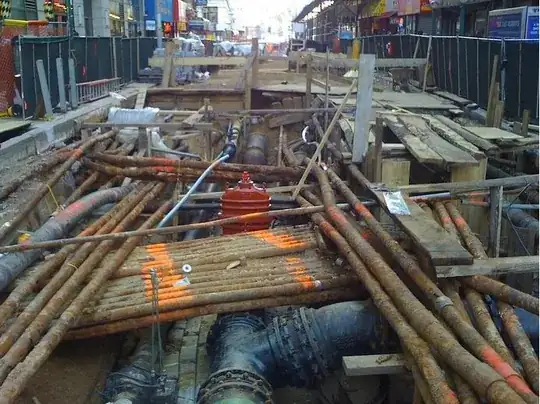

I was told by a foreman at a sewer construction site in New York City that buried water supply lines that run in the same trench as sewer lines must always be above the sewer line, never below. It's because of the potential for contamination from the venturi effect.
You'll understand how difficult it may be to comply with that rule in densely populated areas considering what it looks like under the streets. (Photo credit: davidgalbraith.org)
