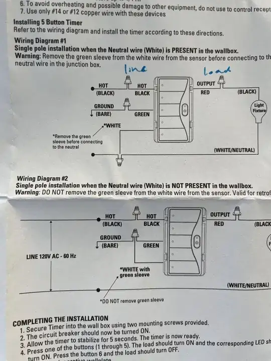

Here's the wiring diagram from the instructions; I used option 2:
wiring diagram
Since some of the comments have questioned the instructions regarding the neutral wire, I searched the product reviews and found this: "It uses the ground as neutral (!) to power the electronics inside the switch. That's pretty bizarre even if the current involved is minuscule." Given that, it does make sense that you would connect a neutral wire to the timer if available, or connect the ground wire to both the neutral and ground on the timer if not. Since the timer does function correctly with the light off, that part seems correct, but what happens when the light is turned on that apparently removes power from the timer?

As suggested by manassehkatz, I pulled everything out to see what was happening. At that point I remembered that the light switch not only controls the fan light but also a light above the sink. The switch box also seems to be acting as a junction box for an outgoing romex wire, probably leading to a half bathroom directly above this room. So that explains all the wires packed into there: one pair coming in from the basement, and four pairs going out to the fan (via the timer switch), the fan light (via the light switch), the sink light (also via the light switch) and the upstairs room (connected directly to the incoming wires).
Anyway, this also made it clear that the neutrals were indeed in there, all bundled together as manassehkatz described. I connected the timer switch to that bundle instead of the ground and then everything worked as expected.
