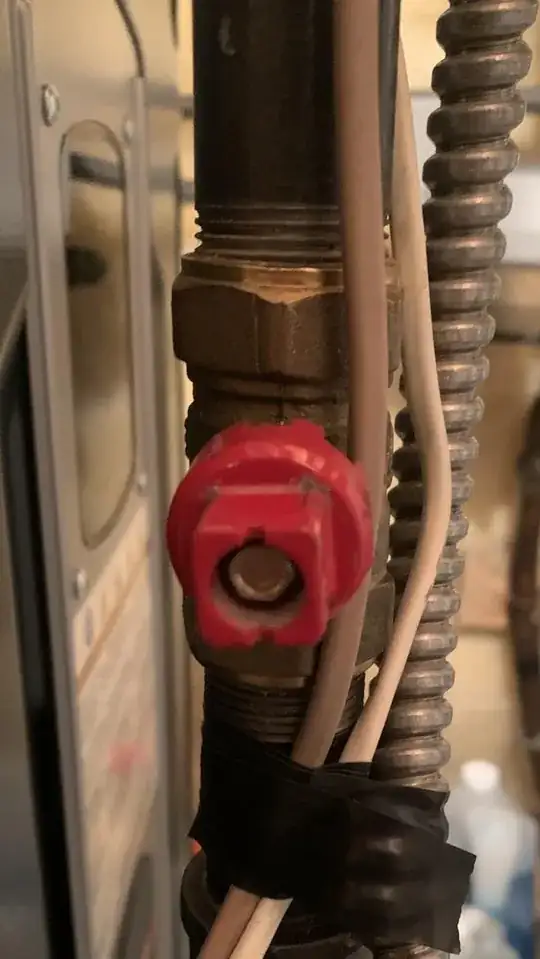

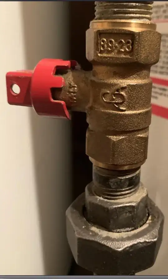

I was wondering how to use this gas shut off valve. It looks like it requires a special type of key but I have had no luck in finding out what type of tool I need.
Adam
  • 203
12
Looks like a plain old adjustable open end wrench (or an open end wrench of the correct size) will operate it. Wrench on the square bit of the red part, turn the whole red part, probably 90 degrees.
A nail, rod, or Allen wrench of the right general size might also work by going through the holes.
How big is the hole through the side? Leverage can be gained by using a screwdriver or even a suitably-sized nail through that hole and (presumably) the one opposite.
An 8 or 12 pointed socket should engage the four points on the square as well.
For limited access, a ring-spanner of appropriate size should get you in there eventually, but you might want a ratchetting one or patience. Your access looks good in the photos though.

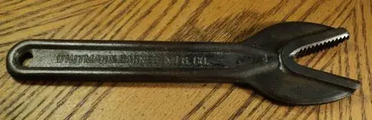

But the "proper" or original tool for these is an alligator wrench which is intended for use on square bolts and nuts.

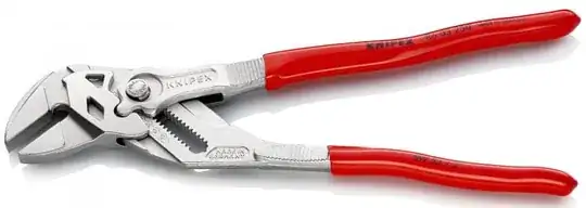

Personally if I was doing this a lot, I'd use parallel-jaw plumbers pliers like these knipex ones The only downside are Price, and that you have to reset every 90 degrees of turn. Minimum is 60 degrees and a lot of resets.

What is it
Pictured is a "flat/square head" valve knob. Its purpose is to prevent operation by hand or by accident, but to allow operation by almost any large enough wrench or flathead screwdriver. You would use it where you want to prevent accidental or mischievous operation but without providing any real security or requiring special tools or keys.
The small hole is so you can install a handle on it and secure that with a cotter pin.
I don't know what the strange detents are for. Maybe the same knob is used for other valves.
How do you use it
Turn it, with anything at all capable of grabbing the square head or the flat slot in the front.

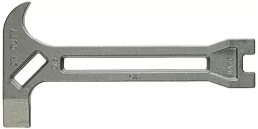

They sell specific "gas shut off tool"s for shutting off gas valves in emergencies. For example, this is a common design that can be used to shut off both gas and water:
