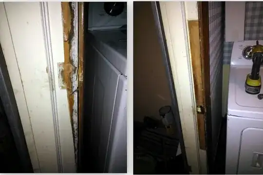

  • The strike plate can be moved, but this gets complicated, as the recess has to move with it. If this is necessary, cutting out and putting in a "dutchman repair", (illustrated below) may be necessary.
Door jamb repair, before and after ©2012 Residential Resurrections
