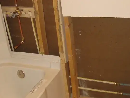

We're doing a minor remodel of our master bathroom, and I have replaced the 30+ year old diverter and nearby pipe with a new one from Delta. Now when any faucet in the house is turned on and off quickly, there is a hammering or banging sound coming from the diverter (2 or 3 bangs). Trying to hold the diverter and nearby pipes firmly still does not reduce the noise, though the diverter is certainly well secured to the brace. The photo below shows the extent of the plumbing I had to do. (Note the wonderful polybutylene at the right which transitions via a Sharkbite to the CPVC.)
Are newer pressure balancing valves subject to this kind of hammering? That seems like a possibility since the old valve certainly did not balance the pressure.
The only other thing I can think of is that I knocked some pipe strap/hanger loose somewhere, but why would it cause the sound to come from the diverter area?
Photo of diverter and pipes

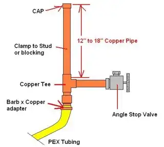

We [plumbers] used to try to stop water hammer with 12-18" capped risers, and this method worked great, just long enough for us to be on to the next job.
The idea was that air would be trapped in the capped riser, which would provide a "cushion" for the fast moving water. This effect, however, is short lived. The air is eventually absorbed into the water, and the riser becomes completely filled with water.

While Tester101 provides a great answer for the classic case of water hammer, my situation is slightly different. The key piece of information from my question was that the noise occurred not only when faucets were turned off, but also when they were turned on. Doing a more focused web search on this turned up this post on TerryLove.com, which suggested to inspect the check valves for debris. Previously I had inspected the valve cartridge, but failed to look at the check valve assembly which was behind this cartridge. Indeed, there were small fragments of polybutylene pipe that prevented the check valves from operating properly. Once I cleared out the fragments from the check valve, the hammering noise disappeared!
