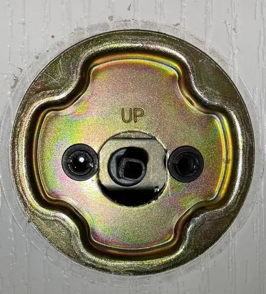

This is a picture of the Kwikset dead bolt from interior. I removed the outer layer. However, I'm having trouble removing the bottom plate.
This looks very similar to this question: Removing old Entry Door dead bolt lock. However, mine doesn't have the inner screwdriver slot. There is nothing for screwdriver to sit and rotate as can be seen from the picture below:
Deadbolt image

There are two small indentations in the screwheads that a large screwdriver will fit into for screw removal.
