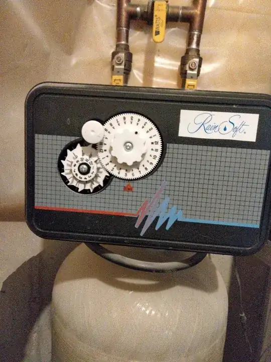

I have a Rainsoft water softener with a mechanical timer with 3 knobs I can turn.
The first (the small one with the arrows) turns a large wheel to adjust the time. This time, I assume, is supposed to be the current time.
The second is a dial that goes from 1 to 12 with little metal bits sticking out at each increment. I have no idea what this is for: Perhaps for setting the frequency in days?
The final is a little knob that sits on the large wheel. My best guess here is that this adjusts when the softener is supposed to run. (The problem with this theory is that I've seen it run even when it wasn't matching the current time, but that was when I was playing around with the knobs so I might have messed something up).

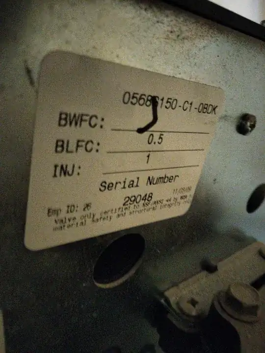

I cannot find any kind of manual (or even model #) for this particular water softener. I've attached a picture of it as well as a sticker that is on the back.
Any help to identify this water softener or the purpose of these dials would be appreciated.
Yes
It runs on a 12 day cycle. You set the metal tab for the days you want to regenerate. Every other tab for every other day, every 3rd tab for every 3rd day, every 4th tab for every 4th day, etc. I can't tell from the picture which position will cause regeneration, if you look close you may be able to tell.
Every 4th day or 6th day would be typical. Note that you can't set it for every 5th day since 12 is not a multiple of 5.
Yes. You want to regenerate when nobody is using water, usually 2 or 3 AM. It won't hurt anything to use water at this time, but you will fill the pipes and hot water tank with hard water.
If you were twiddling the wheels you may have triggered a regeneration.
