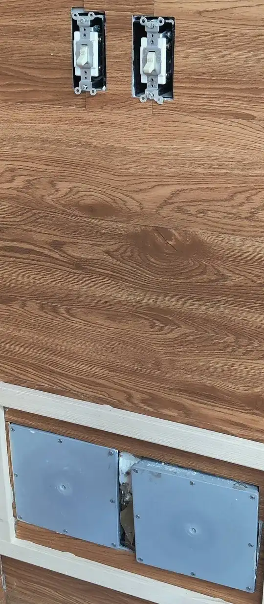

EDIT 2: ISSUE FOUND So we found the issue, it was two switches in the garage that turn on nothing in the house, but the house was using 6 KWH/ hr and after switching it off, it went to less than 1 KWH/ hr. These switches turn on two small boxes that seem to only heat up a lot (hot to the touch) but does nothing else. Have no idea what they are for. Can someone explain what this thing is for?.
Switches with boxes

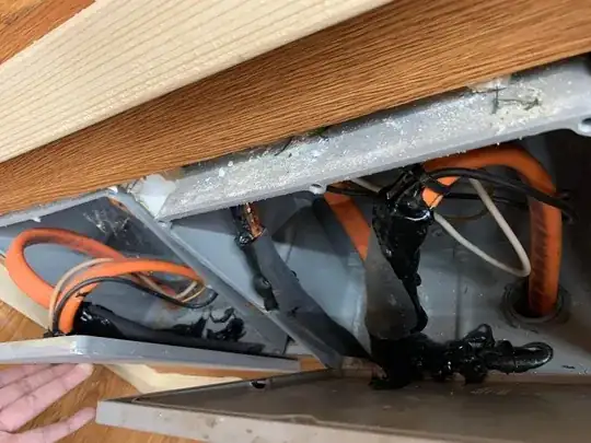

Edit 3: Opened boxes enter image description here
Sorry for slow update. After finding the cause, we went straight to work on the patio and didn't check the thread till after I left. My brother opened the box for you guys here. Appears to be a bunch of heavy duty cables for high voltage. Still not sure where this even goes though, so we are probably going to box off the two switches and change them to smart switches so we can remotely monitor and turn them off if they ever turn on again. I would love to investigate what these are for in the future in another post.
