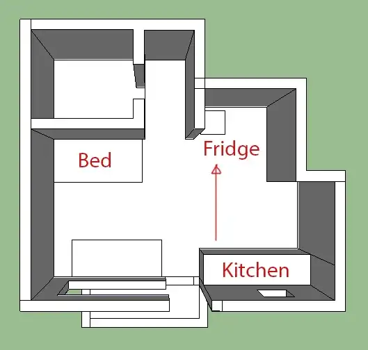

Thanks for your tips and hints. I just moved the refrigerator from the kitchen behind a little wall:
Floor plan with moved fridge
I’m wondering if I could cover this alcove with a heavy curtain (maybe using polyester fiber as HerrBag suggested). Do you think the air volume (~ 0.7 m x 1.7 m x 2.3 m) and the walls would suffice to absorb the heat (and noise) of the refrigerator?
