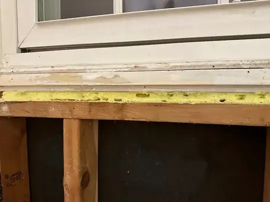

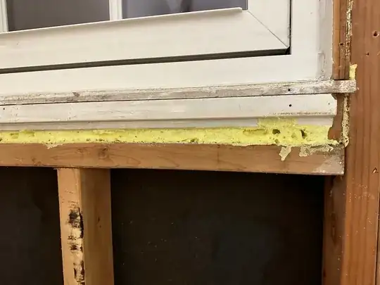

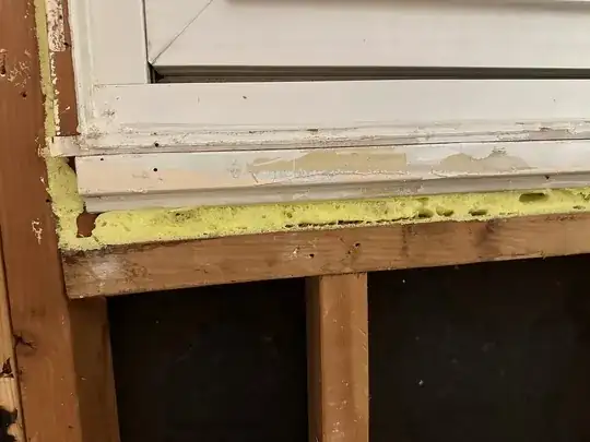

This is my first attempt at sealing a window frame with expanding foam (I used the kind for windows and doors).
I cut off the excess with an oscillating saw blade with teeth, and I'm a little alarmed at the appearance - are all these bubbles OK?
Would I be completely silly to cover it up with some self adhesive aluminum flashing (the kind you'd normally see on the outside)?

Pat yourself on the back you did a great job. You will be saving money on both heating and cooling for many years to come.
It is the trapped air in the bubbles that do the insulating so that is a good thing. As I understand it the smooth outside happens because the bubbles break until and surface tension smooths it out. As the surround material sets up it fixes them in place.
You can cover it as you wish with drywall or whatever. The foam is not structurally sound so anchoring something to it is not a good idea. That will not be a problem as you have a lot of supporting structure around it to support drywall or whatever you decided to cover the wall with.

Yes, it looks fine. I wouldn't worry about the little voids.
Putting flashing over this would serve no purpose at all, and it might make it harder to install the drywall and window trim.
