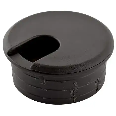

The two types of grommets I use (note: none of these names are official, the official name is just "grommet" which is why there are pictures of each):
black plastic electrical grommet
Black plastic electrical grommet I'll use these when I have to go through a cabinet wall instead of around, when I expect to change cables sometimes but not often, and when I don't care about dust ingress.

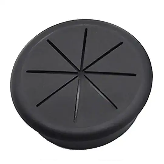

rubber flap grommet
Rubber flap grommet I use these if there will not be wires in the opening and I just want it to look good, or if I care about dust getting in the opening/to the other side. With one or a few small cables, it lets less in than the opening on the other plastic type. These can permanently deform if left with cables in them for long.

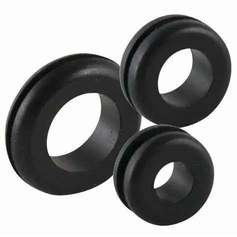

rubber electrical grommet
Honorable mention: tight rubber flange grommet I'd use a large one of these if I don't care at all about dust ingress. Or if I'm using unterminated cables that completely fill the hole, I'd use one exactly the size of the cable and terminate the cable after I feed it through, this can be close to airtight if desired.

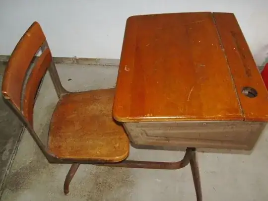

INKWELL If the hole is vertically down through a desk surface, I've heard them referred to as inkwells.
In the past, desks had a hole for a glass bottle of ink to be positioned, so it couldn't fall over. Example:

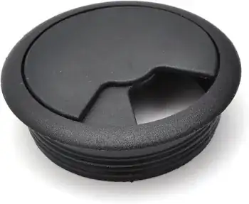

Cut to modern times, computers were being set up on office desks globally. Rather than running a bunch of cables over the back of desks, they were often run through a hole in the desk top, with a trim piece looking like this:
The lid pops out to allow larger plugs through, and clips back in to close up around the narrower wire part. The hole is often 60/70/75mm so check first.
