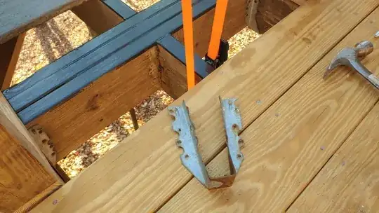

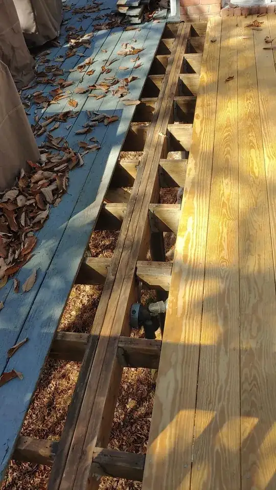

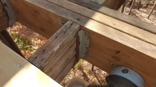

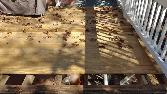

I have a deck joist hanger or two that I was considering replacing in-place if possible. The issue is this deck is 20+' in the air on uneven ground so supporting the joist from underneath before removing the hanger isn't that feasible. However looking at weight distribution, all the newer deck boards secured to it, spreading the weight all over the deck, would it be an issue to remove in-place and install a new one, or could that cause an issue with the joist sinking and making a mess of things? I also could probably use ratcheting straps to the next joists on either side to support from underneath I suppose if needed to distribute the weight.
I've also seen hangers that can slide over the old one and the mounting holes are in a different location, so if the experts here think that's better let me know (need the part number or link).
So is it possible to replace a joist hanger in place on 1 end without supporting the joist from below or is it not possible?

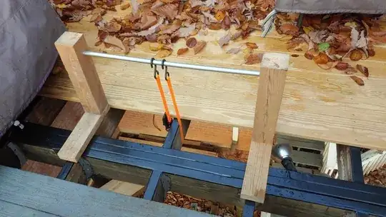

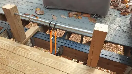

EDIT Here is the solution I ended up using which was a combination of all the advice given below. It uses (2) 4x4s as the posts, and (2) 2x4s for lateral supports that butt up against the deck boards on the backside. The rod is a solid 3/4" steel bar. The ratchet strap I'm using is good for 400lbs, but I have 1000lbs if needed. The ratchet will allow precise adjustment to be level once putting in the new bracket. The thing I like about this rig is it still allows me to work around and under it with clearance. If anyone reads this in the future there are probably a dozen good ways to do this and all the information provided useful.

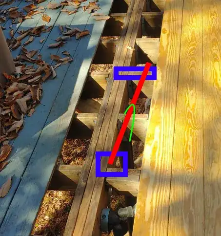

A further option, based on the idea in the answer by Greg Hill, is a lever:
  1. As a variant of #2 and #3, apply a lever resting on two neighbouring joists as in the drawing. Use shims for adjustment, placed between the red bar and one or both of the blue blocks. This requires only one person and is entirely installed from above. No notching of the wood is required if the slope of the lever is minimal due to use of two blue blocks.
You can dispense with the second block if the first one is shallow, thus keeping the lever horizontal enough so that the green strap does not slide off. You can then shim the lever on the non-block side. The blocks can, but do not have to, partially rest on the beam.

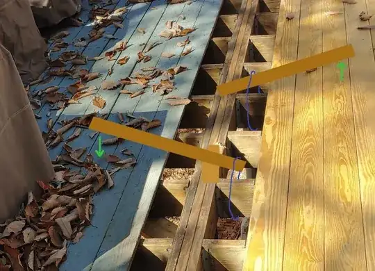

With all the furniture and people moved off that area of the deck it'll take little force to lift the joist tail into position. A person might be able to do it manually, but it can easily be accomplished with a lever (ie a 2x4). If you use the end of the lever as the fulcrum then you can lift on the lever; if you place a fulcrum in the middle of the lever then you can push downward on the lever to lift the joist. I'd choose the former because I can stick a block, a bucket, or some other object under the lever to hold it up without the help of an assistant.
Use chain, rope, ratchet strap, etc to connect the lever to the joist. Arrange things so that the lever is at a low angle. This will minimize the chance of the chain/rope/strap sliding down the lever.
