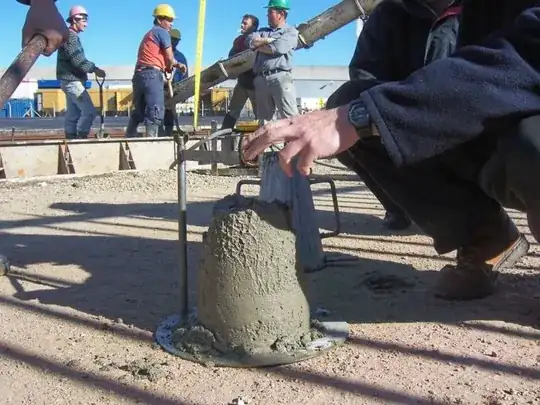

This is often the reason for the slump tests that are done on most large projects. It tests the workability, but also indirectly tests if there is too much water.

One of the measures used when specifying concrete is the water to cement ratio. If there is too much water, the chemical reaction (hydration) that "cures" the cement in the concrete is adversely affected if there is too much (or too little water) in the mix, leading to weaker concrete than if the optimum amount of water is used. Concrete companies measure the moisture content of their aggregates (the sand and stone) to ensure that they add just the right amount of water for each specified mix.
To adjust the workability (the slummp, measured in terms of the amount it "slumps" - or drops - when a cone shaped mound is removed) of concrete, water can be added (and this is often done "unofficially" on site to make life easier by site operatives), but to achieve the specified strength, the workability should be specified when ordereing concrete, as this allows the concrete company to compensate for the extra water by also adding more cement to the mix. For example concrete destined for pumping (which needs high worability to get through the pump) will have a lot higher slump than that used for a straight pour; to achieve the same compressive strength in the finished concrete, the pump mix will have a higher cement content than the mix used for a straight pour.
