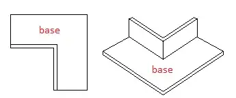

Are there brackets/braces like this -- right angle, typically would be used in corners?
The base turned inside-out, in comparison to this type of bracket:
Or maybe perhaps I could take larger piece of metal part & saw it to get this elusive bracket?

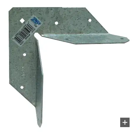

There are "outside corner" brackets, for instance
Simpson Strong-Tie RTA 16-Gauge ZMAX Galvanized Rigid Tie Angle for 2x Joist/Post Model # RTA2Z|Store SKU # 1000170525, from homedepot.com

Assuming you want a metal bracket, not injection molded plastic.
The trouble with the bracket shape you've given is that it requires welding to fabricate. It can't be created simply by shearing and folding flat sheet material. (One might argue that it could be stamped or drawn, but like welding, those operations cost more than a simple shear+bend.)
If you're willing to compromise a bit, you'll find several possibilities that are close to what you're after in the catalogs of the wood construction connector suppliers, eg Simpson.

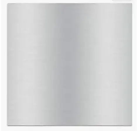

I assume you want a nice solid bracket and not what you find in a lumber isle.
You can simply take a square solid metal with the thickness you like, steel or aluminum, say 1/8" thick, 12 X 12 inch square.
Simply cut its 4 corners to make your base and then cut 8 straight pieces to make the inside component. So that way you won't have to bend them nor do you need to. And it would look nicer too.
Simply use JB weld to join everything.
It will be a satisfying experience.
Hope this helps.
Take care.
Here is a 12 inch square aluminum 1/8 inch thick. It will be perfect.
