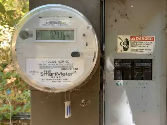

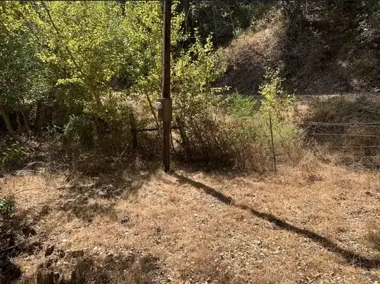

Our current setup is this pole with a meter with 50amp service. It currently provides power for a small barn and a well. (This is a secondary meter on site that previous owners had for their sheep rearing business.)

I bought this Siemens Meter-Load Center Combination, 12 Space, 6 Circuit (https://www.amazon.com/gp/product/B00L2HFH6C/ref=ppx_yo_dt_b_search_asin_title?ie=UTF8&psc=1) but there are not any lugs to send the SE cable out. It I guess just operates on the 'less than 6 switches' rule for NEC and has no main disconnect.

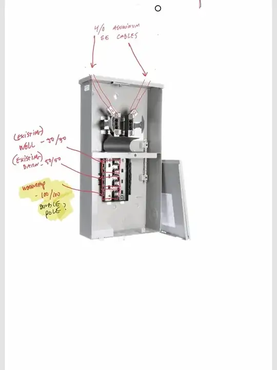

So, With this meter load combo could I....

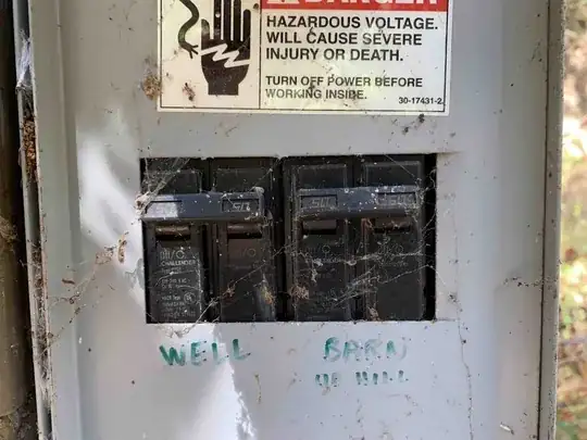

  1. reattach the two double pole 50amp breakers for the well and barn
  2. and then install a 100amp double pole breaker (providing total 200amp) that could send power to a future subpanel about 20' away for the new structure?

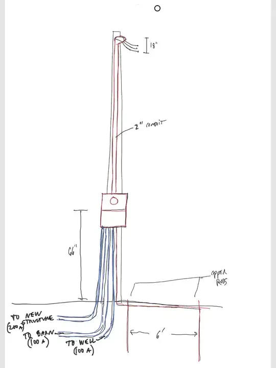

The future subpanel will have maybe 10 different breakers or so: AC, light zones, dryer, electric stove, various outlets, hot water heater, maybe a car charging port in future, etc... Here's a sketch of proposed design:
I think with taking up only 6 spaces total and only 3 switches to throw, I'd be good for fire code? Newer NEC codes might still require an actual disconnect though? If it does work, what size wire would be appropriate to send from 200amp breaker to the subpanel?

Your application is common (at least in North America): sprawling compound, service on a pole, and the desire to web power out to several outbuildings while also sending the whole kaboodle to the house. We have the perfect panel for that, it's called a ranch panel. Meter + main breaker + 8 breaker spaces + the thru-lugs to send 200A to the house. Here's one with meter pan and one without. These things are absolutely perfect for your application - it's what they're designed for.
However... whatever you use for a meter pan (integrated into the ranch panel, or separate) must be on the list of models approved by the power company. They are your first stop while shopping. If it's not on their list, the power company truck will drive away.
That is not how that works. A 100A double-pole breaker is 100A. Just, it's 100A at 240V instead of at 120V. It's weird, here's a primer.

Say whaaaaa?? No, you can't use SE cable underground or hung from a pole line, so I do not see how would get the power to your buildings. You need something else like XHHW in conduit underground (18" cover for PVC, 6" for RMC), or MH feeder direct burial at 24" of cover underground, or quadplex on a pole line. And you will need 4-wire cable.
OperateD past tense. This is probably done in the 60s or 70s when there was a different sensibility toward Rule of Six. Back in the day, 100A+ breakers were extremely cost-prohibitive, so up to six 15-60A breakers could serve as the main breaker. Under the old rules they could even add up to more than the service size, if the dwelling Load Calculation validated. Trouble was, someone would have to re-do the Load Calculation every time they added anything - no one did, and panels burned. So that rule is gone.
The only way multiple breakers are allowed for a service is in 300A and larger services, because breakers larger than 200A are cost prohibitive. So a 400A service is dual 200s. They are not paralleled, they must feed 2 separate panels.
The AHJ's view will be that since ranch panels are readily available at sane cost, they won't authorize one of these.
Rule of Six continues to be allowed for subpanels, and is allowed to be oversubscribed because there is a main breaker upstream.

Please confirm this specific box was on a list from PGE or specifically approved by them in some way, preferably not just verbally. Each utility has particular meter panels that they approve. The lists change over time, and they may allow certain exceptions due to supply shortages. But if you get the wrong thing they won't connect your service.
Assuming that this is an approved box:
The breakers count as the disconnect. They are the first thing after the meter. Rule of 6 in general is not a great thing these days, but this box is specifically designed for that - instead of "12 space/12 circuit" (like a regular panel might be) or "12 space/24 circuit" (double-stuff everything) it is "12 space/6 circuit" - i.e., you only put 240V double-breakers in here, with a maximum of 6 throws, conveniently matching Rule of 6.
(I really hope the Amazon link was just for easy reference. It lists for $ 496 at Amazon! Only $ 125 at Home Depot. Home Depot is out of stock, but that gives you an idea of the correct price.)
Do NOT reuse the old 50A breakers. They might fit. But they are Challenger, which is generally not a good thing. And they have been sitting out for many years. Not worth the possible small savings compared to the risk (and that's assuming they are compatible in the first place). Siemens QP 50A double-breakers are around $ 15 each at Home Depot, and maybe less at an electrical supply house.
100A breakers are a bit more expensive, which is not surprising, but readily available. You have a reference of "200A breaker to subpanel" - pick one. (Harper caught what I didn't - referring to 100A double breaker as 200A - that is 200A @ 120V (which almost nobody needs) but 100A @ 240V (which is actually on the small side for a modern all-electric house). To figure out how much power you need, which will determine wire and breakers, you need to do a load calculation. Actually, do three load calculations - one for the barn, one for the well and one for the new building. The total of all 3 must stay under 200A, but you may end up with, for example, 30A at the barn, 20A at the well and 150A at the new building, in which case you are OK for 200A service but would actually have 3 breakers here (50A, 50A, 150A or 200A) that add up to more than 200A - and that's OK.
For the feed to the new building, use aluminum wire. What size will depend on the size of the breaker in the meter panel. There are a bunch of other factors that may come into play here as feeds to an entire building are different from ordinary circuits. Once you figure out the actual breaker size, one of the real experts will tell you what you need.
