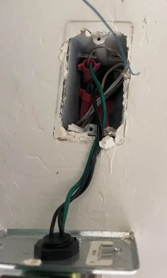

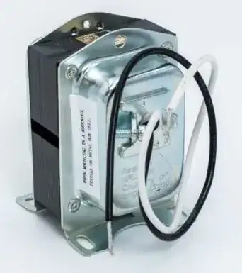

Recently got a new video doorbell and noticed that it was flaky, especially at night when the IR was active. Tech support suggested my 16v 10va transformer could be the reason and suggested a 24v/40va model, which I got.
When I opened the panel, I noticed my old transformer has a 3rd green ground wire, but the new one does not have one (see photos). I don't know what to do with that ground wire, so I'm thinking to send this transformer back and get one with a ground wire - I'm obviously not an electrician but I can connect 3 primary wires - but thought I'd check with those more qualified on here first.

You may not mount this to a plastic junction box. There is a sticker on the device that clearly says "When mounting in a knockout, install on metal box only."
You must mount it to a grounded metal box, or exchange it for one that has a ground wire if you want to mount your doorbell transformer to this plastic box.
