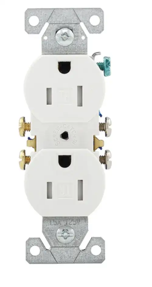

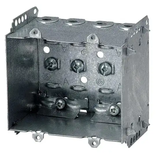

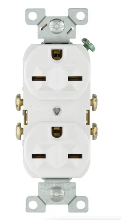

I am located in the province of Québec in Canada and I would like to know if it is permitted here to have these two sets of plugs in the same outlet box:
These 240 Volts outlets:
and these 120 Volts outlets:
in this box:
In Québec it is allowed. I got a 240 Volts outlet installed in the same box as a 120 Volts outlet. A professional electrician verified the work and everything was fine.
