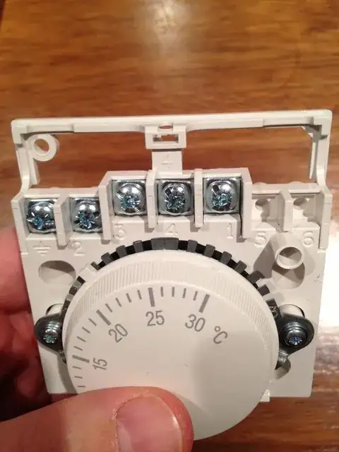

I've tried replacing a Honeywell mechanical T6360 with this Iolloi Wi-Fi (Alexa compatible) cheap thermostat. However, when I wired the mains (UK) N and L to the appropriate terminals nothing happened, so I tried the the wire from pin 3 of the Honeywell in terminals 3,4,5 and 6 yet still get nothing. Can anyone offer any advice or is the unit perhaps faulty?

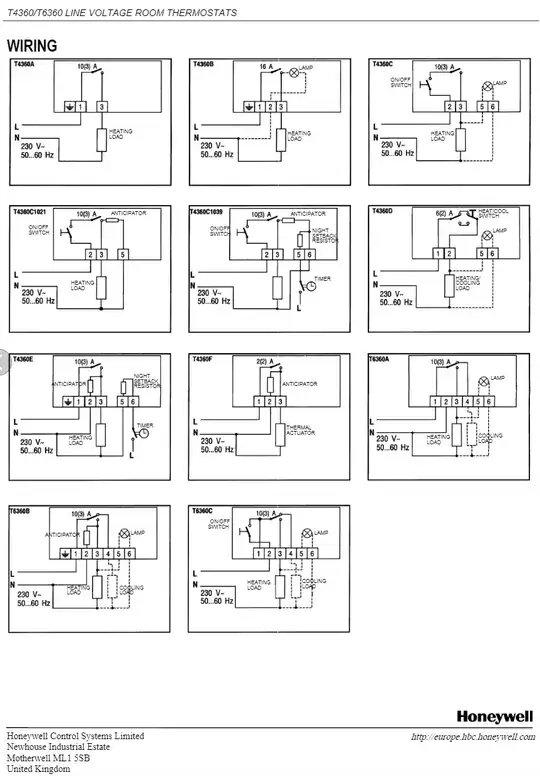

Line 3 from your Honeywell looks to be typically a heating or cooling load in most configurations, (Line connects to terminal 1 or 2, is switched by the thermostat, and outputs on terminal 3 to the heater/AC).
The old Honeywell thermostat has several possible configurations though; maybe identifying which of those you had will help you wire up the new one correctly (safely).
Honeywell thermostat wiring configurations from the manual
