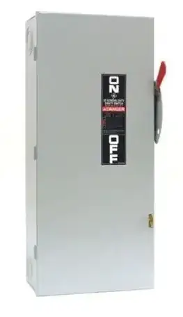

If you're worried about overusing a non-switch-rated breaker too much then you could install a properly rated disconnect:

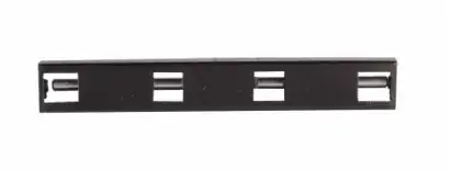

The simplest method, for up to 3 (sometimes 4) circuit breakers, is to use a listed handle-tie to tie the physical action of the breakers together. This is especially effective on 15-30A circuits, which are rated SWD (Switching Duty), made to be turned on/off several times a day. In commercial installations the breaker is often the light switch. Note that 3-pole handle ties are not available for Square D's HomeLine, (talk about truth in advertising), since it's a residential grade panel that does not recognize 3-phase, and so does not offer 3-pole handle-ties.
3-pole are available for all those DIN rail breakers the Euros love.
4-pole handle-tie. Not something you see every day.
