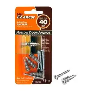

You might consider a hollow door screw. They are similar to the drywall anchors that look like giant screws but are designed for the flimsy type of wood that hollow doors are made of. enter image description here
