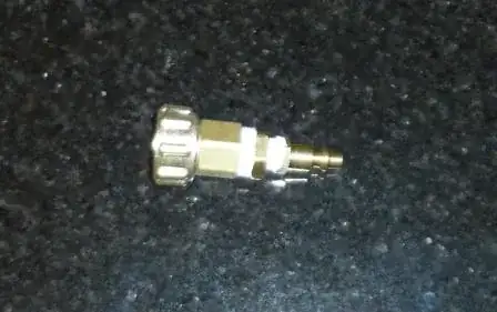

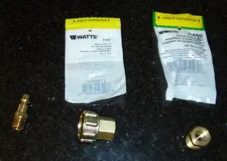

Following the advice of both @Scott Vercuski and @woodchips I was able to build my own adapter to go from the air compressor to the faucet. The three parts are:
  • 1/4" Air Compressor fitting
  • 1/2" to 1/4" Male pipe to FIP Hex Bushing
  • Swivel hose adapter (3/4" FH to 1/2" FIP)
alt text
The three parts combined look like this: alt text
