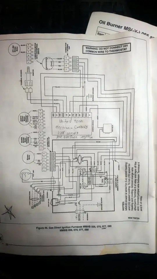

Schematic
Schematic

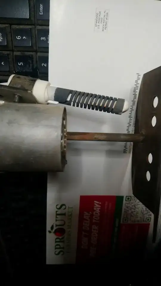

Igniter/flame sensor
this is a photo of the igniter. as mentioned below also operates as the flame sensor. It looks pretty clean, but I'll give it a light cleaning before reinstalling it. What should be the measurement for the 'flame sensor' when the igniter(mode) is not active and the flame is on? igniter

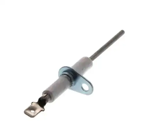

It looks like this, held by one screw. Take it out and clean it, and try again, if not replace it.
sensor
source https://daycon.com/product/nordyne-flame-sensor/
