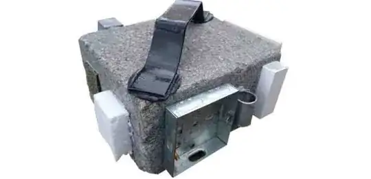

If you like to spend money on adhesives, one that comes to mind is Adiseal. It will stick to concrete and more.
Adiseal
