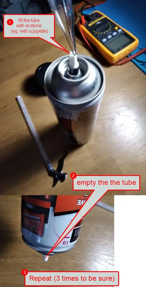

You can reuse the same spray over and over simply by injecting some drop of acetone, then pour it out, and do it again 3 times to be sure nothing remains. The trick is to do it just after using it (like in a few seconds). You can then use a cotton swab to limit the exposure of the plastic with the acetone (but it evaporates quite quickly so it might not be needed).
Idem for the straw and "gun" part (the black plastic part on my picture): as soon as you stop using it, put it vertical, the gun part on the top, poor quickly some acetone on the gun, it will slowly dissolve the foam (it takes 1 or 2 minutes to reach the bottom and to exit the straw ― cf. the warning below about this solution).
Bonus: **by mixing 10gr of polyurethan foam with 80gr of acetone you can waterproof stuff with this water-like substance, but only if you put several layers (at least 3). A single layer isn't hydrophilic nor waterproof, but ‘breathable’. If I remember well, each layer is pierced by some tiny bubbles and thus tiny holes. So, the more layers you add, the more waterproof (but also rigid) it becomes. With this cheap stuff I waterproof my camping gears, and humid walls. Molds can't pass through several layers. (But be careful: acetone can dissolve / destroy many stuffs like some type of plastic). If needed put a layer of paint over it at least to protect it from UV, and because, if you take the cheapest foam, it'll be UV sensitive, the coating will turn yellow, then brown after a few weeks/months (which can be quite nice).
⚠ WARNING: be very careful to not touch the mix of acetone and polyurethan foam, not even with gloves as it contains isocyanates (present in the hardener or catalyst of polyurethane-based two-part paints. It will be dissolved by acetone and will easily penetrate your skin and most gloves ― I recommend applying it using a paint roller or, if you really need to touch it, using Butyl gloves, or (cheaper) 2 layers of latex gloves under some DIY gloves made out of PP plastic bags ― latex gloves will only protect you for few minutes, maybe even seconds).

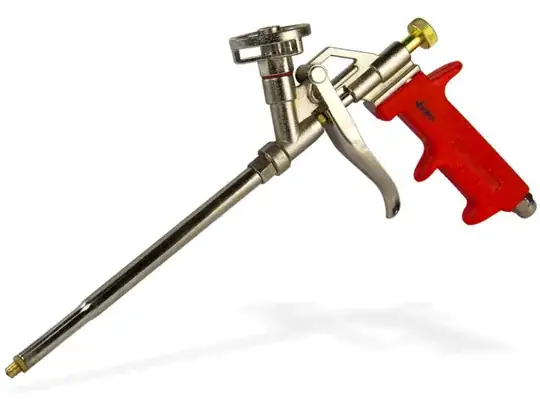

You might consider upgrading to a pro foam gun:
foam gun
You would need to buy a refills, but they are usually cheaper and it will last for months because you can close the tip of the gun.
