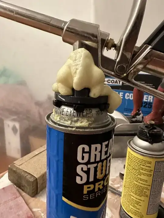

professional spray foam gun leaking at adapter
The can appears to be seated correctly and screwed in firmly. And yet it is leaking foam around the adapter - I saw it starting to slowly ooze out along the mating surface immediately after screwing in the can.
Is this a problem with the gun, or the can, or both? I've already flushed out the gun with the special can of solvent, and the gun dispenses freely.
For reference, this is the Great Stuff Pro 14 model gun. I've tried a cheaper model of spray foam gun in the past, and had this same problem but even worse. The can refused to seat correctly at all, and blew foam all over my floor before I could get to a trash can. I haven't seen anyone mention this issue anywhere else, which makes me wonder if I'm just doing something wrong.

Those cans leak even without the gun sometimes. It's a sealing issue on the trigger mechanism. You can hold the gun itself upside down. I like the cheap plastic guns because I don't plan to use them after a one job use. It takes/ costs so much to clean with mineral spirits and usually will clog anyway. I'm a 18 year industrial coating specialist and have used more expensive rigs for polyurea and polyurethane joint seals in industrial applications and the same problem rears it's ugly head when guys don't get equipment completely flushed. Hope this helps.
