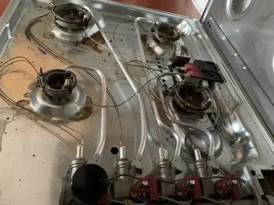

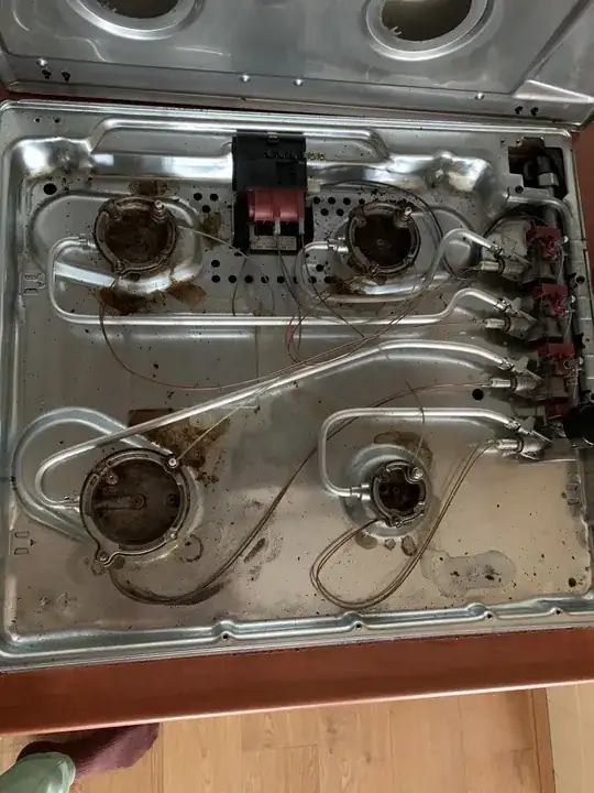

Today, without any special event preceding this I discovered that 3 burners (except bottom right one, which worked just fine) don't sustain the gas flow after you stop pressing black button anymore (even though every burner worked yesterday), doesn't matter many times you try or how long do you press the gas button. Spark & ignition are working just fine this time, no problems with them at all.

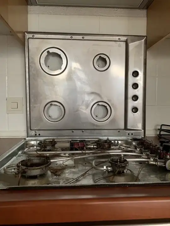

I decided to take the lid off one more time, briefly looked through all the thermocouples (I cleaned all of them as much as I could in the previous part), maybe touched few wires, but in general didn't do anything significant. Then I had the following consequence of actions:

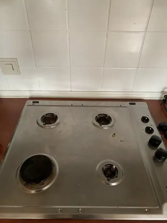

  1. I put the small black lids on the burners to test the thermocouples once again without the stove lid - and surprise-surprise: everything worked just perfect.
  2. I took off the small black lids from the burners and put the big gas stove lid again and the small burner lids again and tested everything once again - everything is working just fine.
  3. I screwed all the screws back, and tested everything once again - this time only two upper burners were sustaining fire, the bottom two ignited well but didn't sustain the gas flow.
  4. I disassembled the lid once again and put the black burner lids to test all the burners again, multiple times - every burner worked well and sustained the gas flow well after igniting.
  5. I have put the big stove lid again (without screwing the screws) - now I tested the bottom left burner and it worked, then I tested the bottom right burner - and it didn't work. And then I tested the bottom left burner once again and it stopped working.
P.S. Every time I write "it worked" or "burner worked" I mean that the burner sustains fire after you stop pushing the gas button on the right. The gas is there, the spark is there, the ignition is happening. Just the gas stops flowing as I take my hand off the button.
