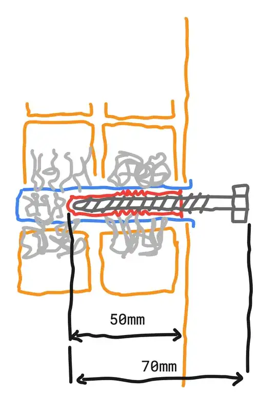

I injected the chemical resin into the socket and then pushed the Fischer plug inside. The problem I found then was that the screw needed a 70mm depth hole and the Fischer plug is only 50mm. From my understanding, those plugs are meant to be shorter than the plug, as long as the hole is big enough, but now that the wall plug is filled around with the resin the screw will only be able to use the 50mm depth of the plug. The picture below illustrates the problem:
wall-side-cut schematic
So what are the options?
  1. Find a smaller screw (~50mm) that can fit the plug (I'm afraid that it will reduce the strength that it can hold)
  2. Remove the plug from inside the resin using a drill, and then drill a hole until I reach the 70mm depth. Insert a new plug. I'm not sure if it's possible to drill through a chemical anchor. Would you recommend doing so?

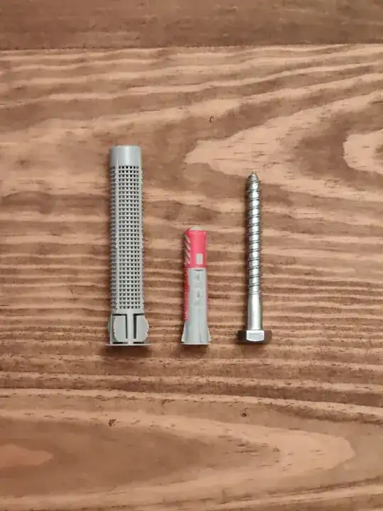

socket, plug and screw

Yes, you should be able to drill the resin/epoxy/plastic with a general purpose drill bit.
If you use a smaller drill bit you should be able to just drill screw-tip clearance beyond the plugs installed, rather than drilling them out and replacing them.
Shorter screws would also be fine in this application, unless you’re planning to use the TV as a pull-up bar.
