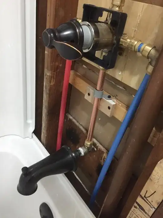

Is it possible to use a SharkBite male adapter on a copper stub out for a bathtub faucet?
I am not well versed in soldering plumbing fittings and I would rather not have to buy the gas, a torch tip, flux, and solder just for one connection. Also, the copper stub out is only about 10" long and connects to Pex in the wall so keeping that amount of heat off the copper would be a good thing, right?

If you are trying to install a screw-on tub spout, it might not tighten up, because the SharkBite adapter will spin. You would need to use a wrench to tighten the SharkBite side, and that would be hard to do inside the spout.

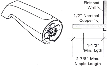

Spout connection types There are three main types of how a spout connects to the pipe
  • 1 Front threaded. The pipe traverses the length of the spout internally, ending in a threaded fitting (usually 1/2" IPS). A front threaded spout usually does not integrate a diverter.
  • 2 Rear threaded. The pipe connection is made at the rear of the spout. These spouts can be either diverters or tub only.
  • 3 Slip on. These spouts will work with just a clean, open copper pipe, as it has a set screw adapter to clamp the pipe.
Slip on tub spout
Soldering to the nipple with the PEX attached is not optimum, but can be managed if you have room to tightly wrap a water saturated cotton rag around the copper and extended over the PEX portion. The water won't allow the PEX connection to go above 212 until it dries out. You will need several inches of bare copper pipe on the end to solder to. (Just TRY to a solder a pipe with any water in it.) Practice your soldering ahead of time and you will become confident of solid, leak free joints.

Here's a bathtub spout install with sharkbite. Run a length of 1/2 copper pipe as needed from bottom outlet of mixer (use 1/2” female sharkbite adapter) to about 4 inches above rim of bathtub. At bottom end of cooper pipe install a 1/2” sharkbite shower adapter upside down. Get a 1/2” steel pipe threaded at both ends from any hardware store. Screw one end into the spout until tight then screw the other end protruding from spout into the shower adapter. Use “tuff” at both ends to avoid leaks. I use a 6” steel pipe. That’s it. Works fine. (I’m not a plumber >>> DIY)
