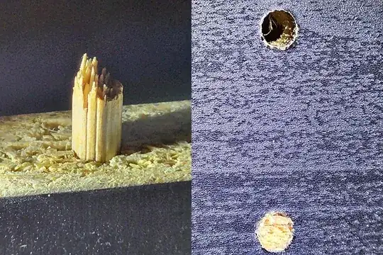

IKEA furniture often has wooden dowels that are used to hold pieces together. The problem is that these wooden dowels break easily when you're trying to disassemble IKEA furniture:
Enter image description here
In the first picture I could just use pliers to pull the broken dowel out, but what for the second picture? I got a screwdriver for a watch screw and tried to use a hammer to try to get it sufficiently far in there such that I could kind of lever it it, but that did not help.
So what are my options for the second picture?

There are several techniques.
  1. Locking pliers gripped to the dowel (perpendicular) and hammer on the locking pliers to pull the dowel out of the material.
  2. pre-drill the dowel slightly smaller than the diameter of a #8 screw, screw into the broken dowel and then use technique 1.
  3. sometimes the dowels are actually glued, in that case you can cut flush and then use a drill and drill bit to drill out the portion of the dowel still in the hole, generally you take a replacement dowel and find 1/2 the length and mark that on your drill bit so you don't over drill. a drill guide can also be used to keep the drill bit centered on the hole. Generally I just get a piece of scrap wood that is at least 1/2" thick and then clamp or hole it such that the hole lines up with the cut off dowel. The guide will help you keep your drill plumb with the hole as you drill out the left over dowel.

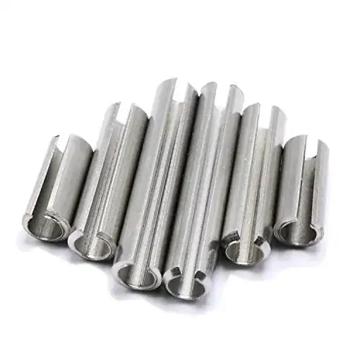

"Metal Dowels" are quite easy to come by...
...if you shop the right places.
Look for spring dowel pins and ignore the results that don't look mostly like this.
They come in many sizes. You'll probably get overcharged less at a metalworking supplier than random web vendor (who's just buying them from a metalworking supplier, or crap quality you don't want from elsewhere priced as if they were buying it from a reputable vendor and marking it up.)
The "spring" aspect means they are a bit more compliant than hunks of solid steel.
You can get hunks of solid steel in almost any size (diameter) you like as drill rod (usually 3, sometimes 6 feet long - possibly 1 meter & 2 meter elsewhere, or for metric diameters) and cut to length with a hacksaw or metal-cutting disk. Steel dowel pins will find you precut ones.
Murphy please fail to notice me, image of spring dowel pins from Amazon (I'm actually surprised it loaded, TBH)
Screws to remove the dowels
For your second picture, put a small screw partway into the dowel, then use any suitable tool (claw hammer, prybar) to lever it out. Failing that,
Drill out the dowels
Get a drill bit slightly smaller than the hole (you don't want to damage the sides) and drill out the broken dowel. Nice and easy, just a little more messy than the first option.

I've bought a large number of used Kallax and Expedit shelves and encountered this problem more times than I care to remember.
Step 1:
Obviously if there is enough dowel sticking out a pair of pliers will get it right out. Don't use clamping pliers, you are likely to shatter the dowel.
If that fails:
Step 2:
Some have suggested drilling and screw pull, but i found if I used a smallish phillips wood screw I could skip the whole drill step.
Screw in a half dozen threads.
Step 3:
Claw hammer that b**** out of there.
This has never failed for me. Good luck.
Note:
Oh, and remember that Ikea provides free small parts replacements on their website. You're gonna need a new dowel (or three).
MrPeach
Screwing a screw into a dowel may cause it to expand and stick in the hole. You can minimise this by drilling a pilot hole that's similar to the core diameter of the screw (self-tapping screws typically have a straight core while woodscrews are typically tapered). Drilling the entire dowel out is possible but needs to be done accurately. If all else fails, another option would be to drill a small hole and glue in a piece of wire using epoxy resin, then pull out the entire thing once it's set.
