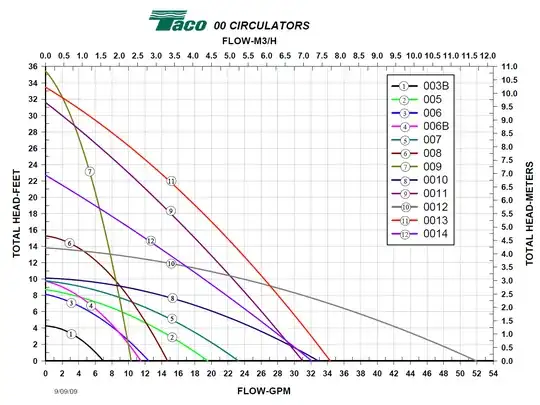

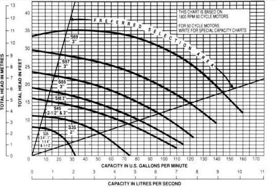

Armstrong S25: 1750RPM; 1/12HP; 9-32 Flow-GPM (original system circ, was ideal setup)
TACO 007: 3250RPM; 1/25HP; 10-24 Flow-GPM (problem: few pops after boiler startup)
TACO 0010: 3250RPM; 1/8HP; 10-33 Flow-GPM (problem: water flow sound + wailing when boiler heats up)

The Taco 0010 is not the closest match for the Armstrong S25. The S25 is 8 foot head at no flow and 32GPM free delivery. Those match up with a Taco 008 circulator.
The Taco 0010 is 14’ shutoff head and 56 GPM free delivery. It’s pushing much more water through the pipes, which as you noticed can be noisy.
That said, I suspect you’re hearing air gurgle around because you need to purge the air from the system.
