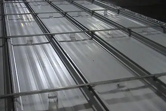

Specifically, how can we shim the standing seam pans from below when the roof is installed? Below I show a commercial solution that stabilizes the panel pans with a network of purlins mounted above the metal panels, but it's a complex and rather expensive proposition.

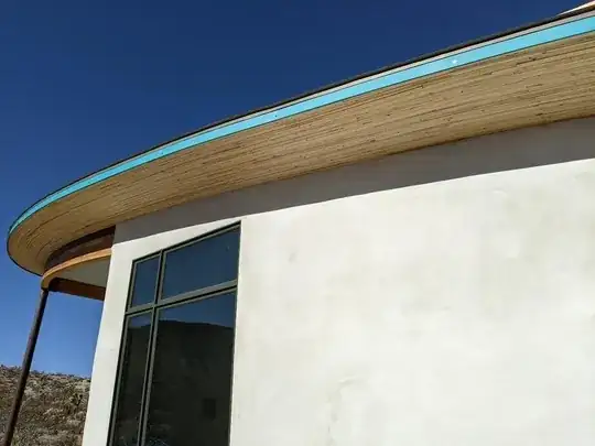

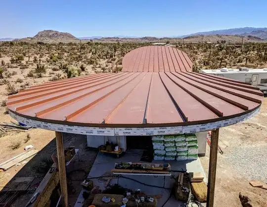

Purlins mounted above are at least possible to access, since before I started hearing the wind 'roar', I counter-flashed the whole roof perimeter in metal and a weather barrier. That is, the area under the metal panels is sealed for waterproofing, as seen in these side and end views:
Side view of sealed roof system
End view of sealed roof system
I'm looking for ideas that won't require that level of intrusion, or require penetrations in the metal panels to insert shims as the latter would defeat the whole point of a waterproof metal roof.

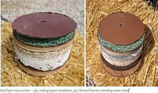

The roof is composed of the following layers: ply, roofing paper, insulation, ply, thermal barrier, standing seam metal, as shown in the photo below:

So far as I've seen, the only commercial solution on offer are Windbar external purlins that partially prevent panel uplift. They do not eliminate noise completely and they are both expensive and -- at least to me -- are ugly as sin:
Windbar installation
