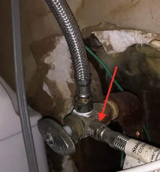

I need to replace some parts on my dishwasher that will require me to turn off its hot water supply for at least a few hours, maybe a day or two. There's an existing supply stop valve (see picture below) but it doesn't fully shut off the water, even when cranked really tight. It also turns off the kitchen sink's hot water which is annoying. I can turn off hot water at the water heater, but I can't leave it off for a long time or my family will kill me.
I'd replace the supply stop valve, but given the rust around its connection to the water pipe, I'm nervous that I'd break the supply pipe while removing the old supply stop valve.
Over the years I've had to make multiple dishwasher-related repairs, and the difficulty shutting off the water makes it a pain every time. And I suspect this won't be the last repair that I have to do here. So I'd like to figure out a longer-term solution to the incomplete-stop valve.
So as part of this repair, I was thinking that it'd make sense to add a new supply stop valve downstream from the current one, and attach it where the current flexible hose is attached. (See red arrow below.)

  • What part(s), both the stop valve and any other parts like washers, will I need for this work? It's 3/8" compression (see label in picture below) on the end of the supply line heading to the dishwasher.

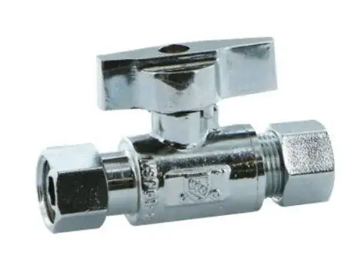

The downstream add-on stop valve you are looking for is called an inline "repair stop valve". Its upstream end has a captured nut and seat to exactly fit on the "compression" outlet of your existing valve - just remove the outgoing hose, install the repair stop on the outlet, and put the hose on the outlet of the repair stop.
Here's an example "3/8″ O.D Comp X 3/8″ O.D Female Comp 1/4 Turn Straight Repair Stop Valve"

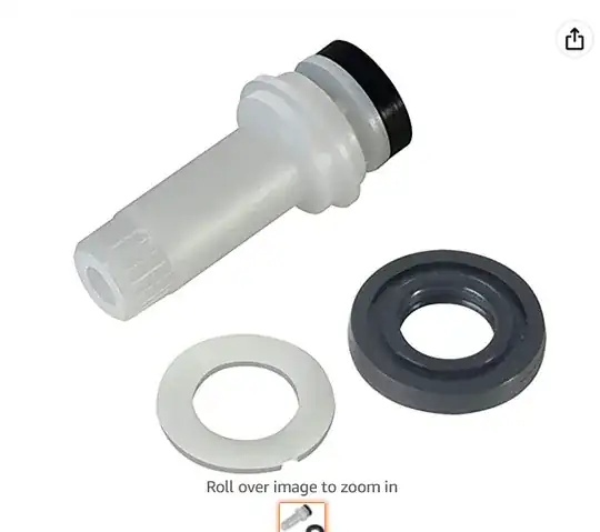

Make sure any broken pieces of rubber gasket are removed from the insides (I usually remove the attached outgoing hoses to make sure nothing goes into them). Then, then, reassemble using replacement parts from something like this multi turn valve stem repair kit:

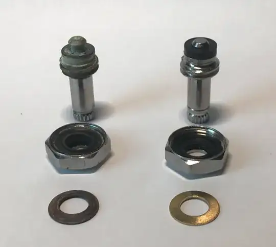

The larger rubber washer fits inside the packing nut and the metal washer fits over the shaft of the stem (packing nut tightens against it). Here is a sample view of old worn parts on left and new parts on right. The metal shaft shown is higher quality than the plastic and is available individually as a brass part, which I would recommend instead of the plastic replacement for durability.
