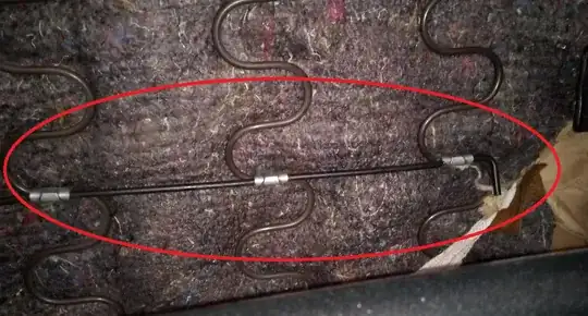

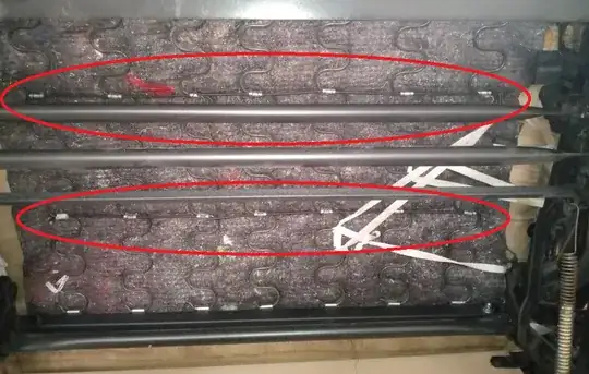

One side of our couch sinks in way too much. I really don't want to fork a money for a new couch right now, so thought I'd see if I could fix it. I flipped it over and underneath I found that 3 plastic rods that run horizontally ( circled in red in the picture ), are broken. The rods are crimped the the squiggly spring things with some sort of clasp ( circle in red in second picture ). I'd assume there's a special tool required to make the crimps/clasps? Does anyone know what these items are called, and if they can be replaced, especially on a DIY project? If not is there a good work around or substitute? I appreciate any help or advice. Thanks

Those are called stay wires, and they can be replaced.
When a person sits on the couch, a certain number of the zig-zag springs will be directly underneath them. The stay wires link the springs together so the weight of the person is distributed among more than just those springs, making the seat sink less.
They are attached with stay wire clips to your couch's springs. Yours are specifically "three prong clips." Your couch has sinuous or "zig-zag" springs; some very high-end couches have coil springs that are tied together, like some mattresses.
The traditional material for stay wires is paper-wrapped steel; the paper helps prevent squeaking. There are pliers made specifically for attaching three-prong clips, such as the Osborne No. 445-3 Spring Clip Pliers (online store chosen at random from Google), but you can attach the clips with a regular set of needle nose or lineman's pliers and a little extra effort. If you want to save money and aren't going to start a stay wire repair side business, it's probably not worth buying the special pliers.

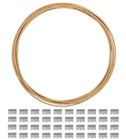

Here is one kit with replacement wire and clips; similar materials will be available from various shops online. They're available in various lengths with various numbers of clips included; measure your couch and count your springs to make sure you've got enough coverage.
House2Home Upholstery Stay Wire for Sofa
Note, you may choose to bend the ends of the stay wires into an "L" shape after installation, like how your current plastic stay wires are shaped. This prevents them from sliding laterally in their clips; if you like to lie sideways on the couch enough, the wires may actually begin to slip out quite far and can even protrude out of the couch!

You should be able to work those clamps loose with a screwdriver and needle nosed pliers. Remove the broken plastic rod pieces and check your home store for a steel rod the same size. I had trouble finding one so I got a heavy steel coat hanger, straightened it out and used it instead. Then "wrap" those clamps around the rod with some pliers.
