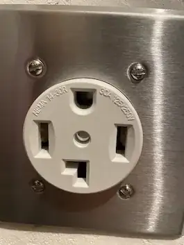

I have an electric vehicle mobile charger that is plugged in to a dedicated 30 Amp circuit.
When I’m done charging, I undock the charger from the car. I leave my mobile charger plugged into the 14-50 receptacle.
Instead of unplugging and plugging in the mobile charger from the receptacle, I flip the breaker off/on depending on when I’m charging.
Is this bad practice? I did some research and I read that a breaker has a mechanical duty of 4000 - 6000. And can be tripped 3 or 4 times before it has to be replaced. I also read that everytime you switch it on/off it damaged the breaker a little bit.
Are any of those findings accurate? Should I just leave the breaker on?
Update
Based on comments and responses below... I have changed the receptacle to a 14-30 (note: the existing wires are 10 AWG.) Also, the car and the app limits the charging current to 24A max, 80% of 30. (Before, when I had the 14-50 set up, I had to manually reduce the charging current to 24A b/c the max was 40A, 80% of 50.
14-30 receptacle
