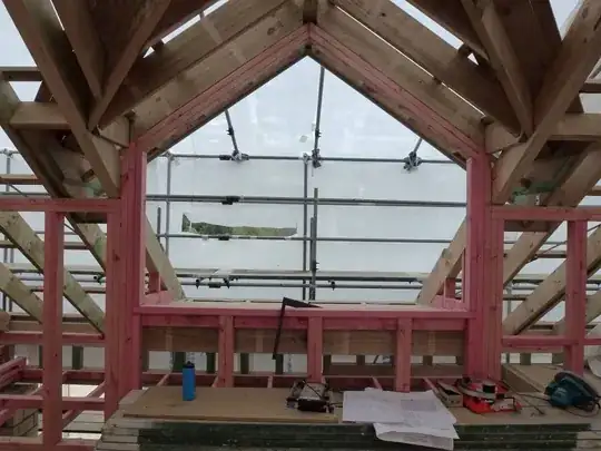

One way is to wrap the building, as we did. This sped up the construction time and prevented damage to the framing.
I am not sure if this is worldwide. Some years ago, New Zealand moved from the tried and tested way to treat framing timber by dipping. At this point in time, it was sprayed on and was supposed to last a few weeks in the rain. Less, if you have made any significant cuts to it. In New Zealand, we have all 4 seasons in one day. Realistically, the framing could stay in the weather getting rained on for a couple of months.
The slot/flap you see, is for materials to be delivered in from outside.
