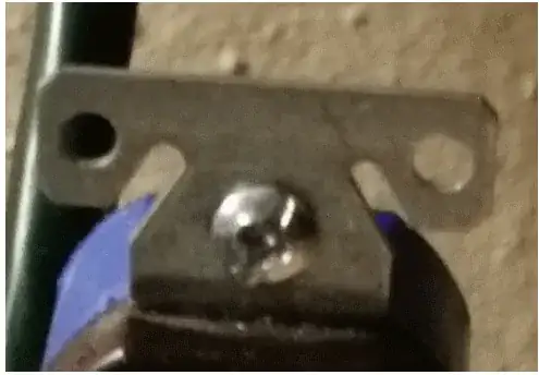

Original image of screw in yoke
A Phillips bit does not make it and a straight blade either.

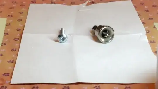

The bit on the right fit that screw the best.
I went looking thru my screw drawers to find a replacement of better design.
