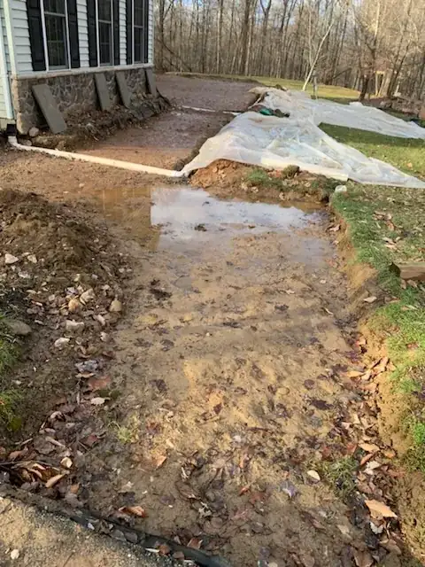

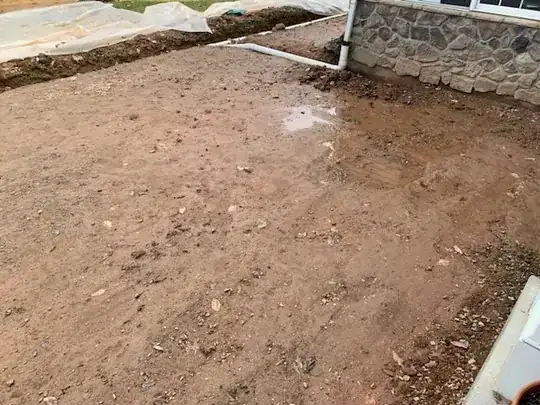

We have excavated for a paver patio and walkway at our home. It’s a fairly large area and we missed getting the base laid and compacted before the weather turned cold. We now have a large dirt area that’s been laser graded and unfortunately it hasn’t stopped raining long enough for the area to be dry so that we can lay the fabric, base and then compact. Would it be harmful for us to lay the fabric, and put 1-3” of the base layer down just to prevent it from being muddy all winter and then let it dry out in the spring, compact and finish when the weather is nicer and the ground is no longer frozen? enter image description hereenter image description here

You can place the fabric and base as you intended. Any rain would only help compact it without it being constantly muddy.
